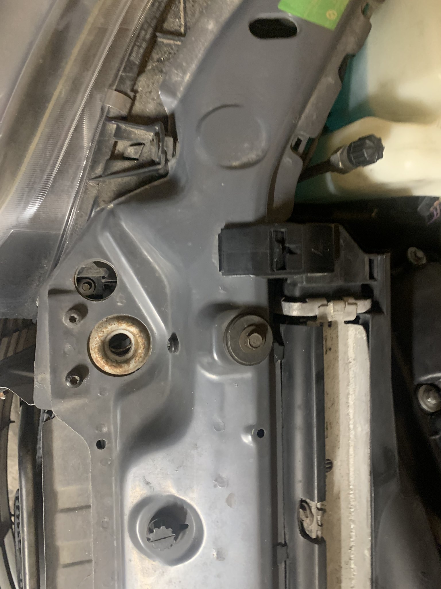

Two on the top of the radiator support
4 on the front of the condenser...

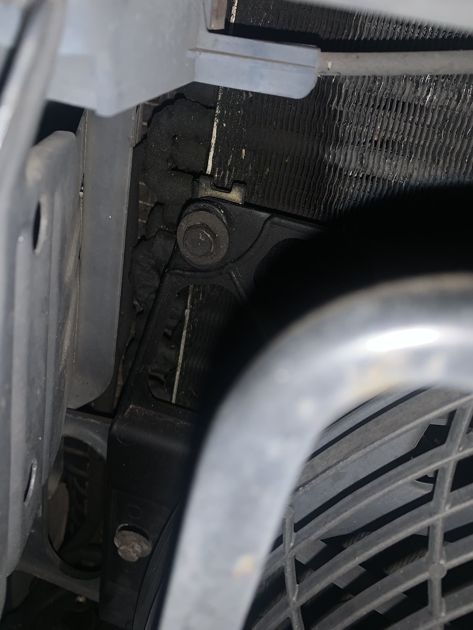

Two on the right side

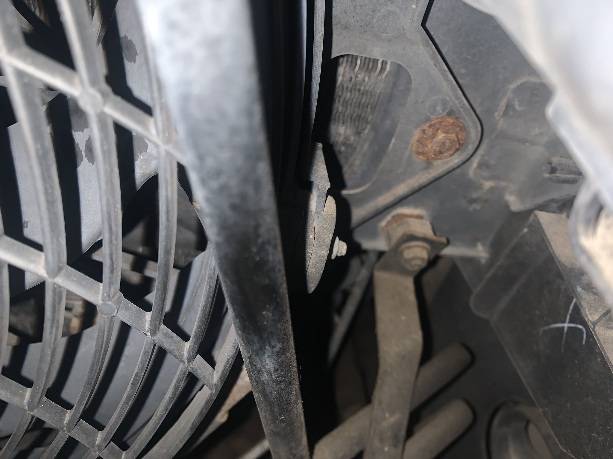

The lower left bolt

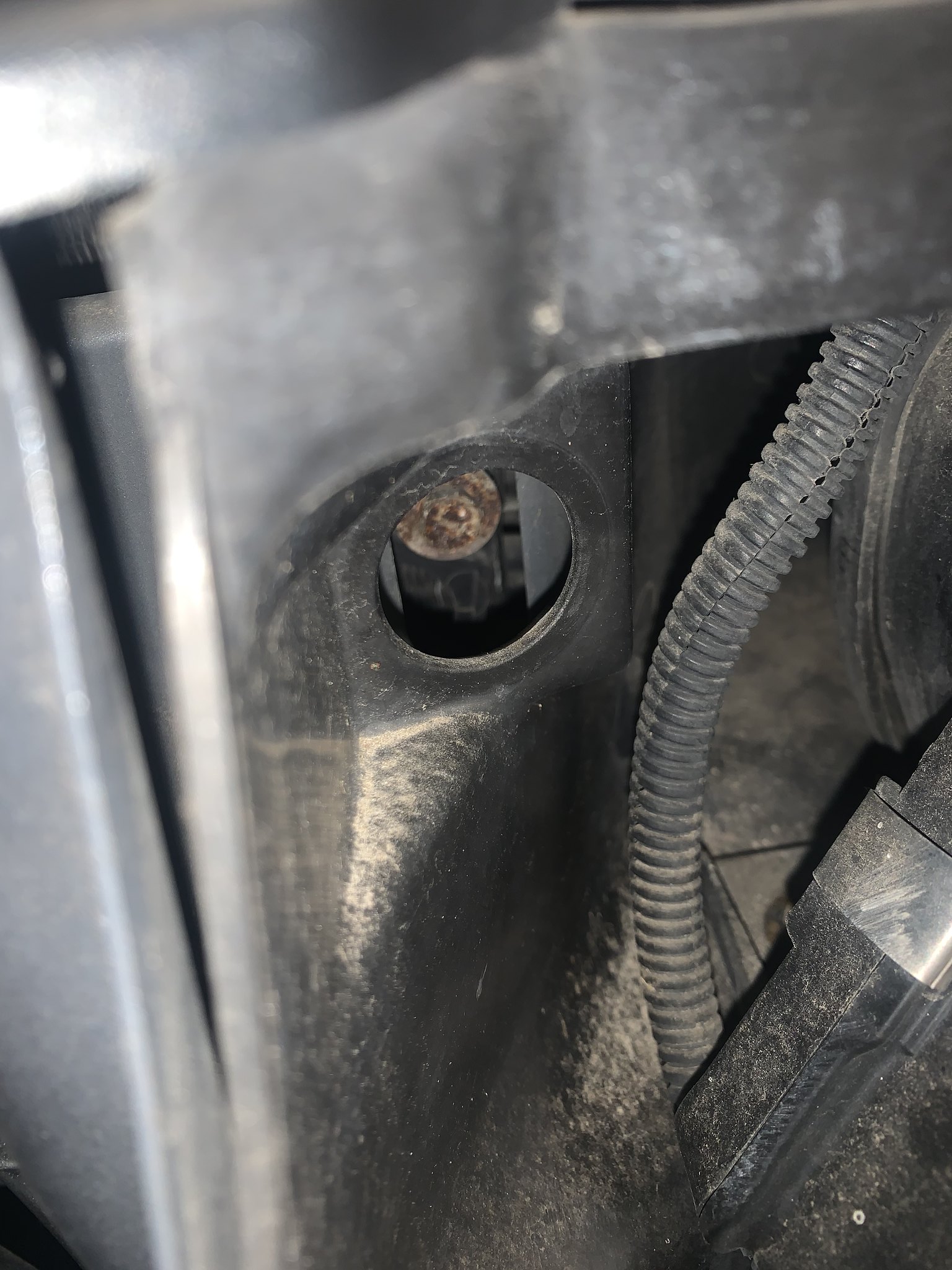

The upper left bolt - need to look into the opening

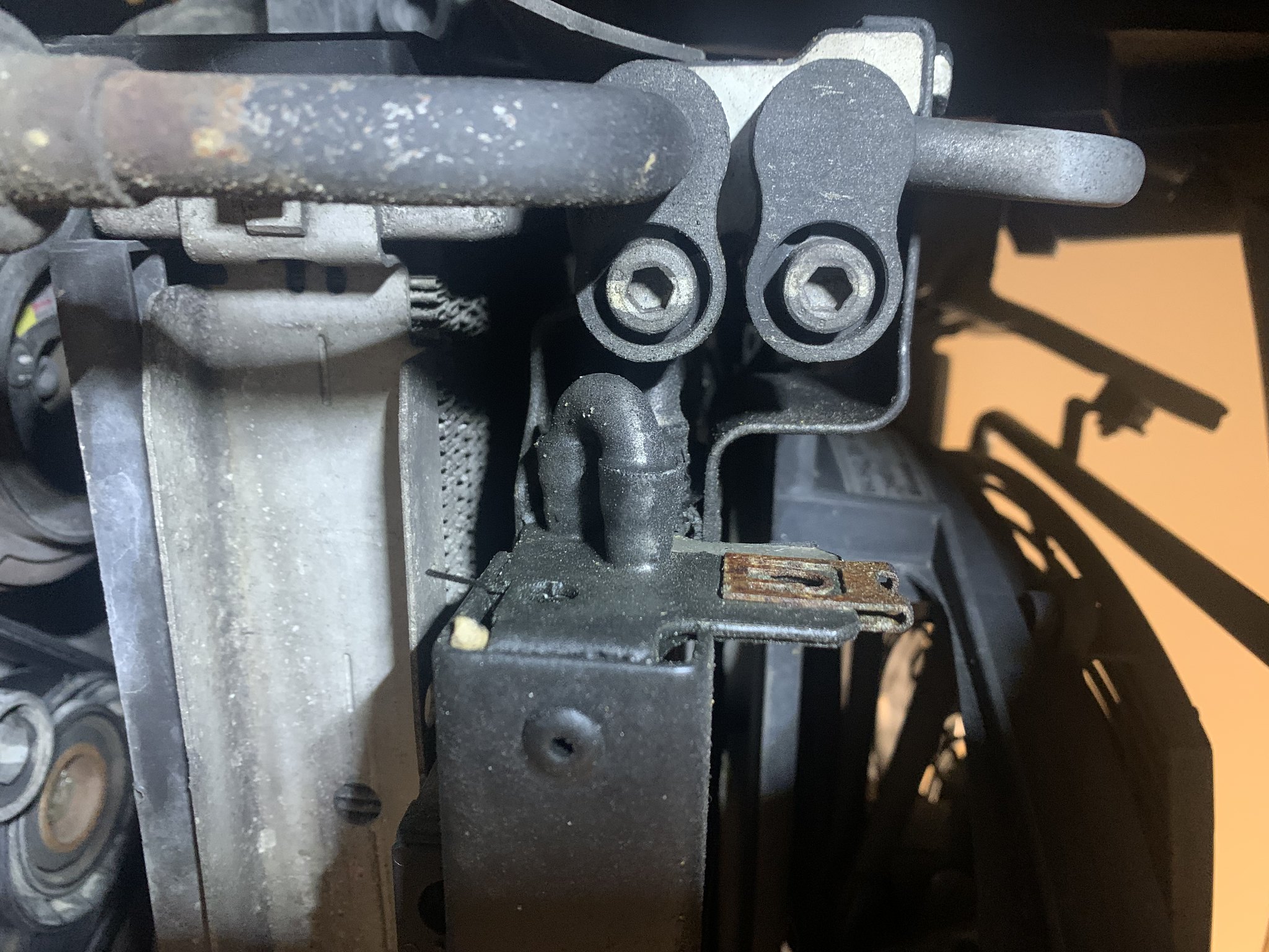

Two 6mm hex bolts which hold the lines.
