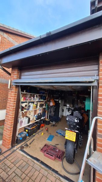

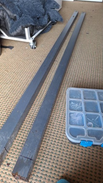

Think I may have come up with an idea, just need to do a bit of cutting and drilling.
Im going for the garage door as a lifting point.

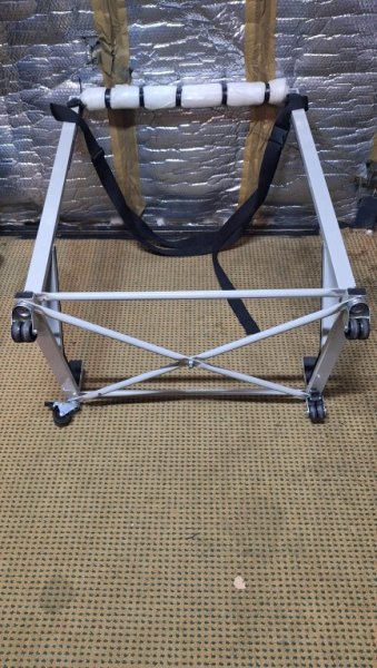

It’s a two person (male) job unless a rig can be set up to hoist the hard top off. Use a thick blanket to protect the boot lid when lifting off. I use a trolley type storage solution. Good luck.

Did scratch the rear right wing once. My fault though coz didn't tell the missus about the spike. It's not heavy though so should be an easy two man/woman job as long as the assistant is aware of how it goes on/off.
But now I have a hoist in the garage although that's not perfect either and always a bit worried in case the rope slips through my fingers. But then I'd just have myself to blame.

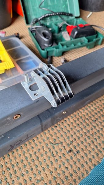

Anyway, on with the building process. Fits over garage door nicely, Just need 2 straps and I'll be having a go at a slow lift.

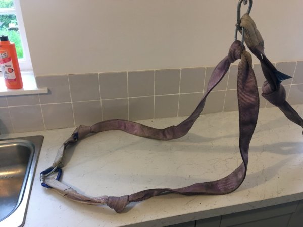

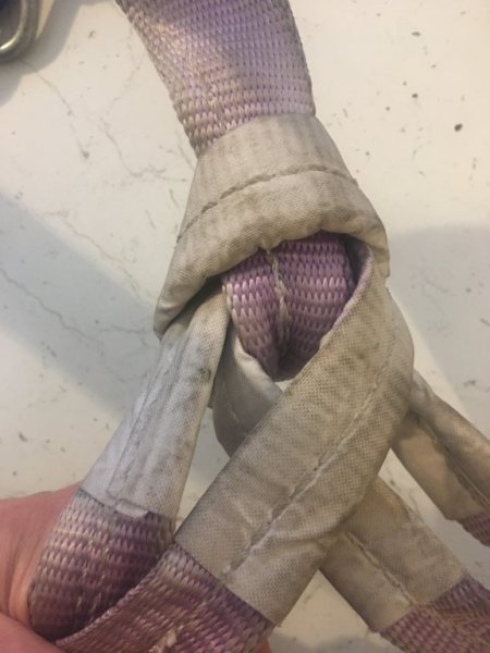

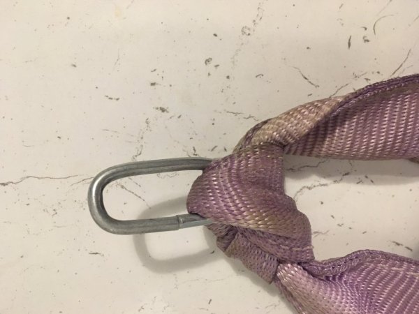

To lift the hardtop horizontally: Get 5 webbing slings and 4 carabiners. Form a ‘Y’ with 3 of slings. This is for lifting at the back of the hardtop, behind the window. Hook the loops at the end of the slings around the spikes on the hardtop.
The other two slings pass through the car, to be connected by carabiners.
Connect all slings together above the roof, as shown in this pic.

Thanks for the image and write up..
I'm waiting on the straps to see how i go, ideally as yours i need to be as far back as can as a lifting point due to restrictions on the working area.

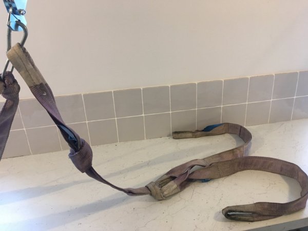

These 2 pass through the car, to be connected inside the car by a carabiner.
Also shown how all slings are connected together above the car (sorry for multiple posts, but don’t know how to post & comment on more than one pic at a time.,.)

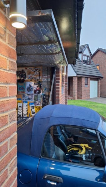

I've half chickened out with the lift.
Going to take off the roof and lay it on the ground then configure the straps. Only need to lift a few inches to see how it'll react. No dramas then.
If it works, again I only need lift it clear of the spikes to the bodywork, move the car then lower on to the trolley.
The weight baring frame over the garage doors is from the legs of an old Gazebo i've been meaning to tip but been too long for the car boot.
Plenty of dog blankets on the drive and should be ok !🤞

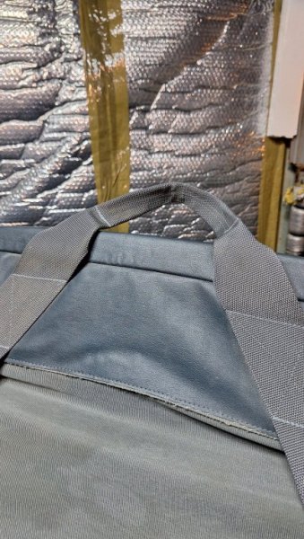

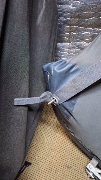

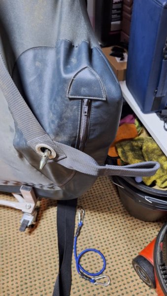

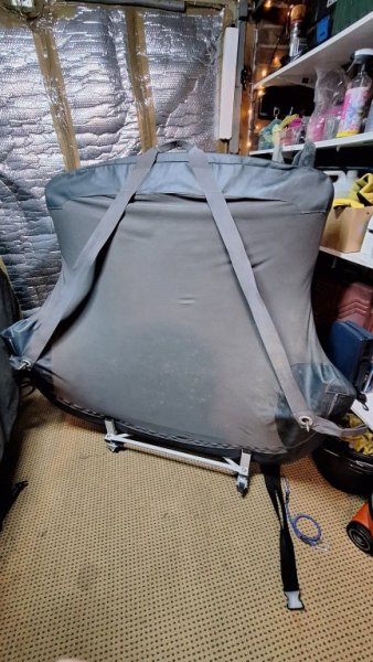

Took the roof off in preparation for trying out the lift.
Decided to put it away in the bag it came with which ive never used.. funny to find 3 ideally placed handles that the hoist could link into dead easy, sussed ...
However the drama, and I think it would be, would be getting the cover on the roof whilst it's still sat on the car, seems a huge faff but I'll consider it for the ongoing project.

Pretty much sorted, just need a shorter straps to pull link that im happy with. 2nd image link up is more level. Cars right for position and able to actually get out.
Seems to go high enough, times ticked on as darkness fell. Actual proper go at it once the impending rain snow buggers off.
