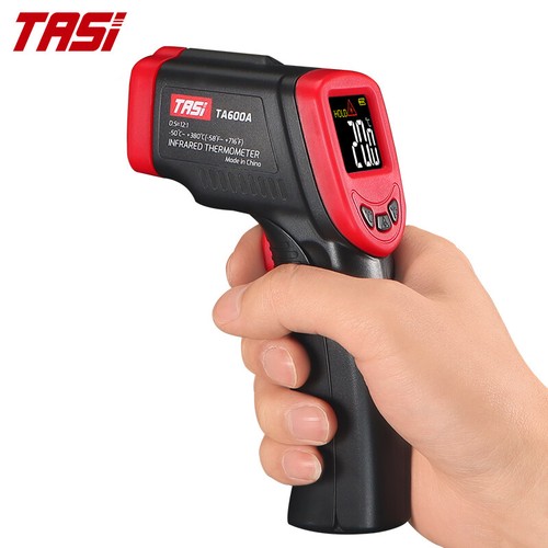

First thought would be faulty thermostat. Have you checked to see how hot it gets before it opens? You need something such as this.
Also very handy for testing brake temperature if you have a calliper sticking too.
