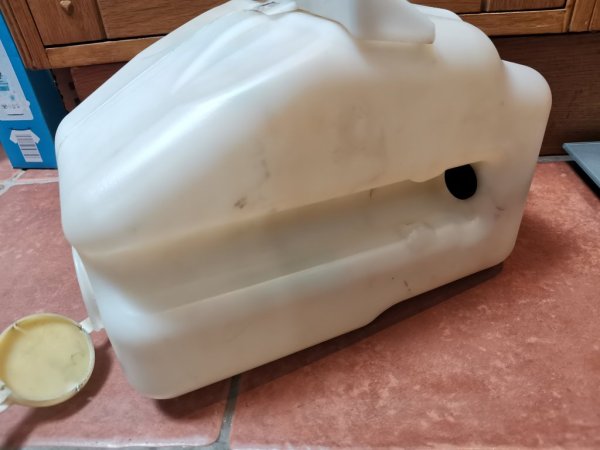

I noticed when I filled my washer bottle up the other day fluid leaking onto the garage floor.

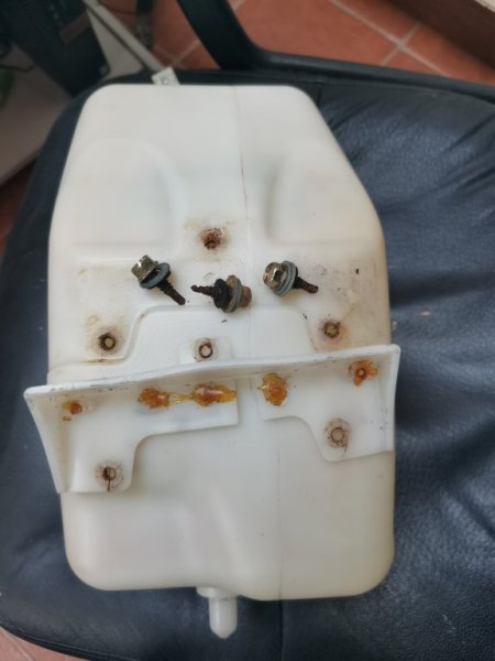

Took the bottle out and could see it had been repaired before by a previous owner..
I see from previous threads that they are notorious for leaking where the bulkhead bracket that is attached to it by some sort of plastic welding.

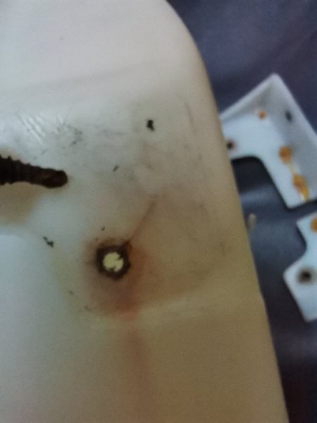

My previous owner had removed the bracket and drilled holes in the bottle and used some rubber washers and self tapping roofing fasteners to attach the bracket
It's leaking from one of these holes.. The fastener appears stripped and has a small hair line crack in the body of the bottle..
It's made of polyethylene which is notorious for being very difficult to glue.
Any suggestions on how to fix this?
I would simply get another one from. The breakers if I could but the bottle has two pump holes. One for windscreen and one for headlamps which is very rare on a Z3 and so far I have been unable to find a replacement
. Hence the fixing option is currently necessary..
Any thoughts??

For a while, silicone sticks will do the trick for you but will not last for more than a year or so.
In order to seal this you will need to find an flat iron long enough to reach the hole from inside the tank, melt the silicone to completely fill the hole while said iron is keeping silicone from dripping and when it starts to become solid again press gently from the inside so as to make a flat surface covering the hole and then some more on the perimeter.
Then repeat on the exterior.
This worked for me many times and I hope what I say makes sense.

Personally I would just replace without the headlight washers, just makes a mess imo took them off the e86 even though they worked!
Mike Fishwick
Zorg Guru (II)
French Zeds
Sep 23, 2021
109
Daglan, France
2.8 Roadster
I would remove the auxiliary air pump, and find a larger tank which would fit in place of it. Have a look at a breaker's stock of tanks. You may even find a tank with a headlamp washer entry too. Perhaps a tank from an alternative type of BMW would do the job - I am not sure, but I think I have seen such a washer tank on a facelift Z3?
