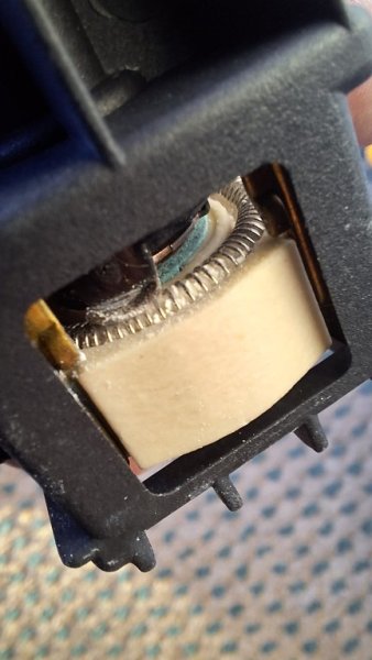

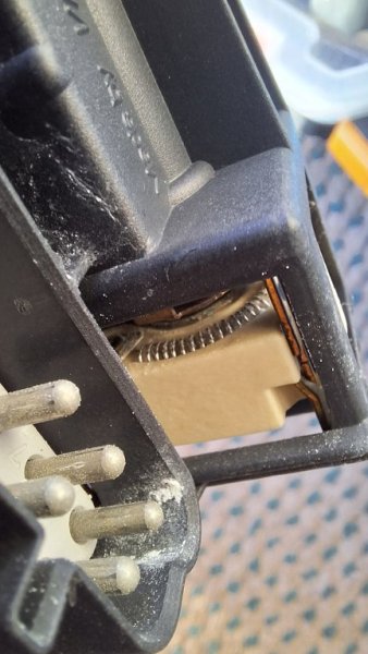

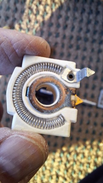

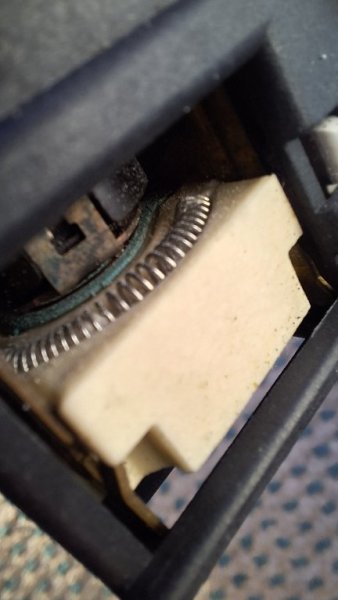

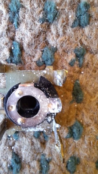

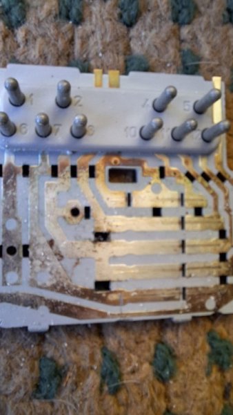

Bit the bullet and went outside. Only showing minus 1 so cracked on.
Took the unit out which was reasonably easy. Saw all the obligatory white dust which once the unit was out i blew away.
Closer examination found the units coils to be in really good condition. Took the unit apart, cleaned and sprayed then dosed with ACF50, polished up the contact dial and 'Bob is my Uncle'.
Turns very smoothly, no scraping noise and illuminates all through the turn from nothing to bright. Tried to add a video but too large, try again later.
Well chuffed. Mega thanks to you all, gave me the confidence to go and tackle it 👏 🙌 👍

Well chuffed. Mega thanks to you all, gave me the confidence to go and tackle it 👏 🙌 👍 View attachment 354775
Well done!
I may have a go at mine following your success.

Honestly well worth it. If I can do it anyone can !
Dont forget the small screw above and BEHIND the light switch, only thing I missed for about 10 minutes 🤦‍♂️.
Other to bare in mind, the illuminated light icon might drop out. To replace it once finished do it Without the bulb in its holder, then put in the curved holder/bulb receptical, then lastly plug in the bulb.

I had a go at mine today.
The only problem I had was releasing the headlight switch from the vent housing. Luckily I was able to release it by just pressing in one of the side retaining lugs.
I don’t think I have the dexterity required to press in both lugs and pull the switch at the same time.
There was plenty of the white dust that causes the problem.
I was able to blow it out and clean up with contact cleaner without having the take the switch apart. There’s enough access at the back of the switch to clean up all of the rheostat.
All working smoothly now.
