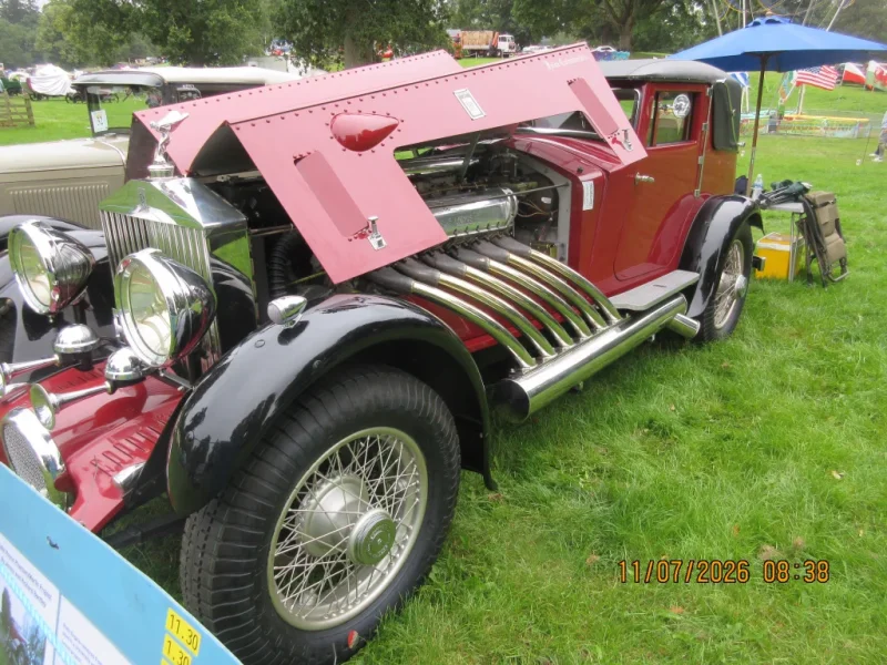

Ok guys ...maybe this will whet your appetite...240mph, 1200 bhp ....and 24 spark plugs ...will this keep you happy? !:whistle:;):whistle::)..taken at a local show and needless to say one knew when it was "fired up" !
Merlin Spitfire engine in a Rolls Royce !
