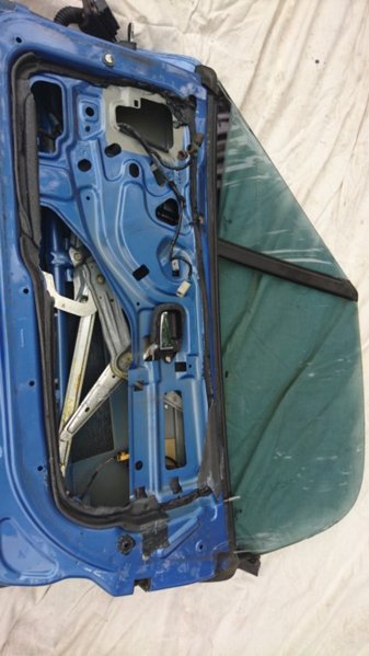

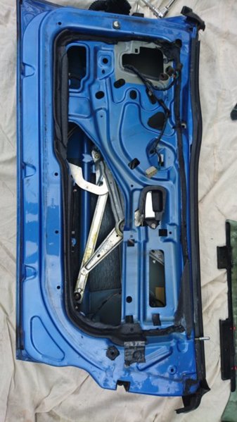

As title a quick how to remove guide, took a few photos as i removed the lifter scissor style glider for a member on here.
Please note there is no need to remove the door! I just had to work on the car in my narrow garage.
First you need to remove the front 10mm screw/bolt in the base of the door - nearest the engine.
Then, the two 10mm screws/bolts on the inside of the door where the electric mirror control would be (roughly speaking)
Then, with a good wiggle the front smaller (quarter) glass will pull up and out, it is very tight at the end.
Then, the main body of glass (part that goes up and down when using the electric windows) slides forwards (towards the front of the car) and lifts out quite easily.
Then remove the four 10mm nuts that hold the scissor style lifter/mechanism. They are quite obvious, but hard to picture. The central one is the one that had snapped off of the door strengthening impact bar on my coupe and needed re-welding to the body of the door - the failure of which led to the mechanism repeated fouling until it broke.
There are two 'push and pull' electrical connectors on the motor, beneath the wing mirror mounting point at the front edge of the door to remove.
Then, with a lot of swearing and scraping of knuckles the mechanism can be removed.
I took it out with the motor in the 'up position, but it might be easier in the down position, as the door was off the car it wasn't that easy to experiment!
Relatively quick, only need a 10mm socket and ratchet.
I hope that helps someone.
