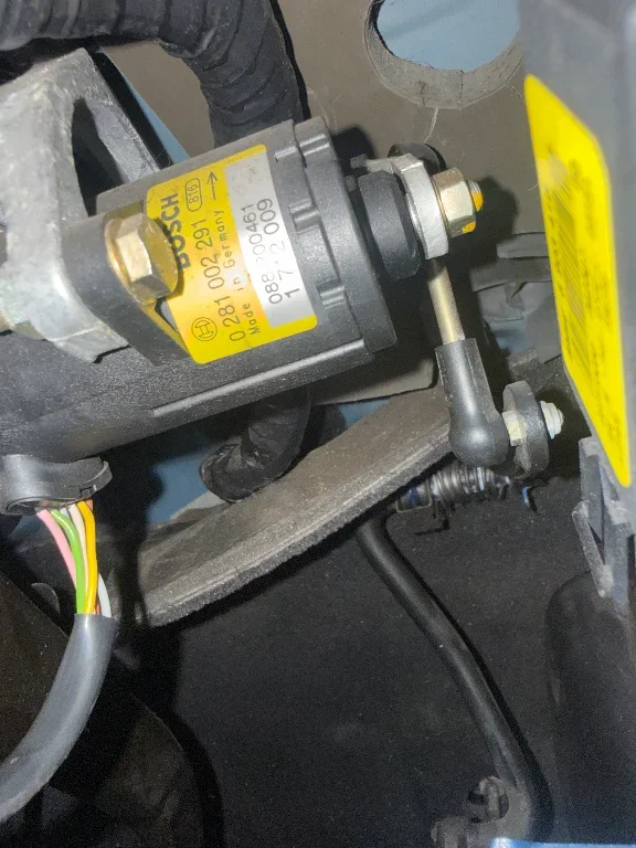

I can’t find a separate throttle position sensor on the throttle body housing on RealOEM for the 3.0 M54 so I think it’s all built into the throttle body itself.
The throttle pedal position sensor appears to be part 12721712009 and is quite expensive however I can’t see that part number on the actual pedal sensor - see photo

The exhaust sensors probably have burnt out heaters in them hence the code you get. Check for continuity on the heater wires on the sensor, if they are open circuit then they are burnt out and not working.
