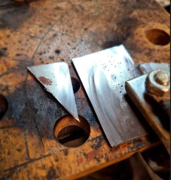

Took a day off today but wasn't going to spend it all in the garage.... but.... as I was in there..... decided to try and fabricate the end of the sill... this is 2mm plate by the way...
first up was the template the end piece, and this is how it currently looks... like piranhas has been at it...
My standard three layers of masking tape !.. I suggest that's a minimum to prevent it tearing...
After cutting out, I offered it up to the sill and bent it to the right angle
Then lots of fettling with a pin hammer.. I couldn't find a ball-peen hammer.....
lots of offering up, banging with a hammer... lots more offering up
and finally getting a decent sort of shape
Not going to cut it out as weld it in until I' mentally ready again ! =)) =))
a mock up of how I hope it ends up...... end... geddit... end....
