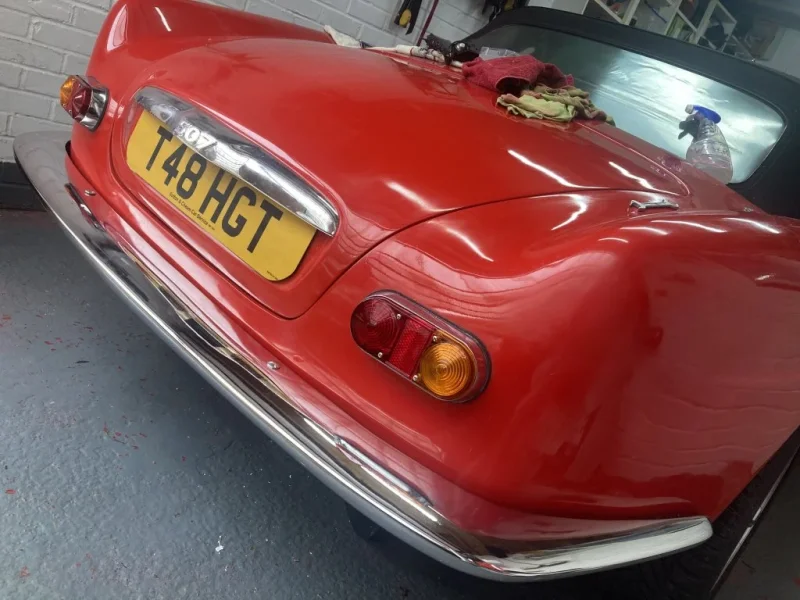

I'm not sure you know what I mean. I think you are talking about the boot leaking - I don't mean that.
When it rains the rain may sit on the boot. When you open the boot lid, that water goes in the boot. It looks like your problem won't be as bad as mine, as your boot slopes and the rain may just slide off it.
I saw this on another thread and immediately thought of our little discussion about water on the boot lid falling into the boot.
At least it's not this bad (I hope) :3santas: ...

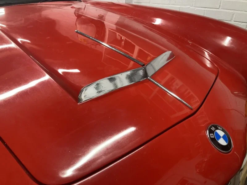

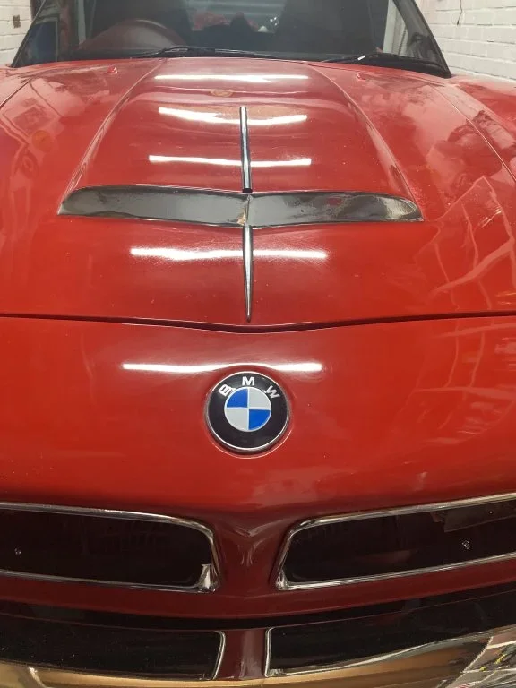

A couple of bonnet upgrades. The air intake is wrap but will be changed to either Ali or Stainless steel later on. The streaks up the bonnet are stainless. I think the upper one is too long but will see how it looks once I get the car outside
