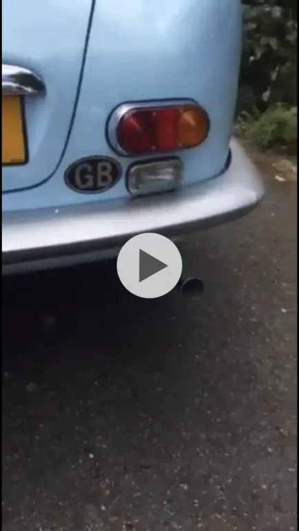

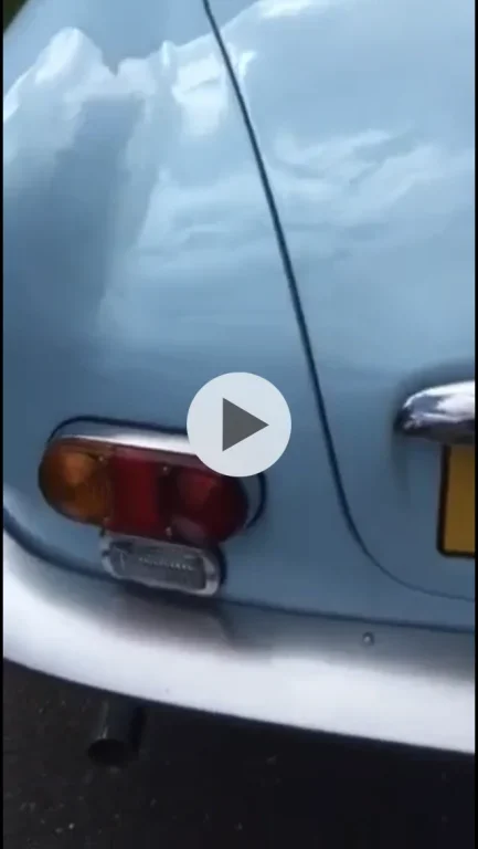

Well progress:
I have all the rear lights on and working - the fog and reverse aren't excatly vertical and I'll have to measure the distance from the floor (hopefully it will just make the 250mm). The boot catch is now on ad working (including with the central locking), boot is tidied and loom wrapped.
Wheel liners are on so moving forward it's the fuel flap and finish sanding the back panels, but I'll probably go forward and start on the headlights.

I might get reverse lights to go there, Steve has done this and the blue car that’s also finished
Here you go
Ah, hadn't seen that before, was looking for something period (hence the chrome), well I'll se what it's like when I get her down.
