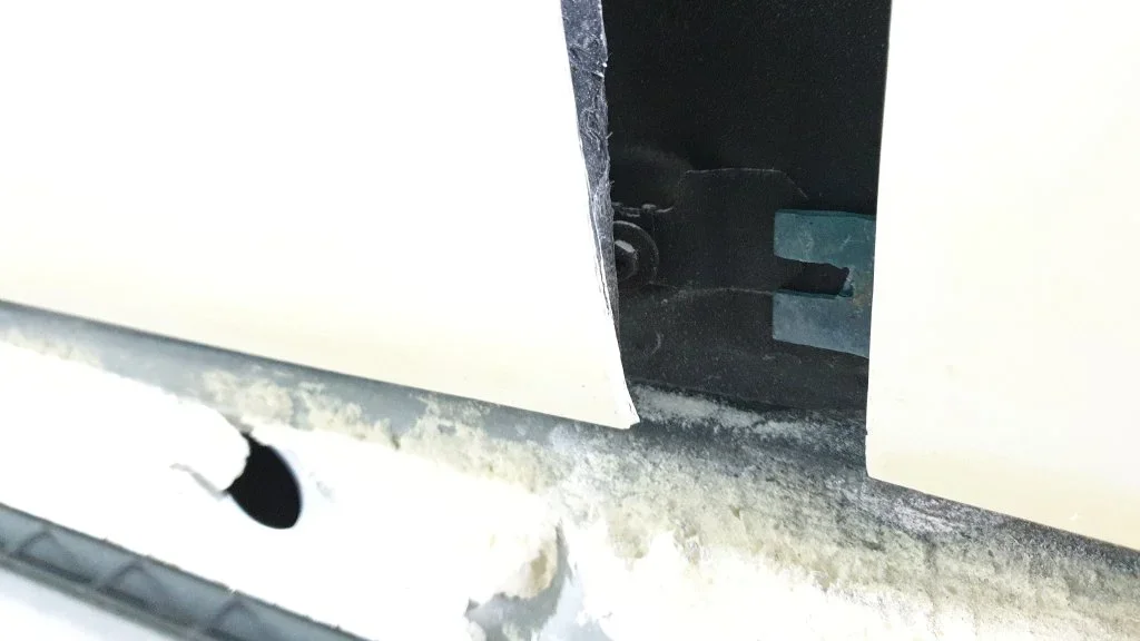

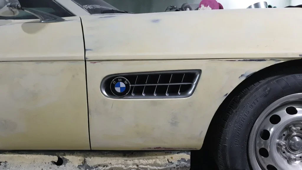

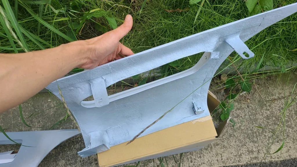

Panel gaps around the car were actually pretty good.
Except for the doors. Which are terrible

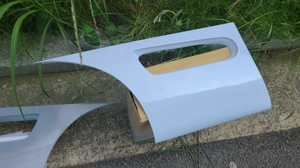

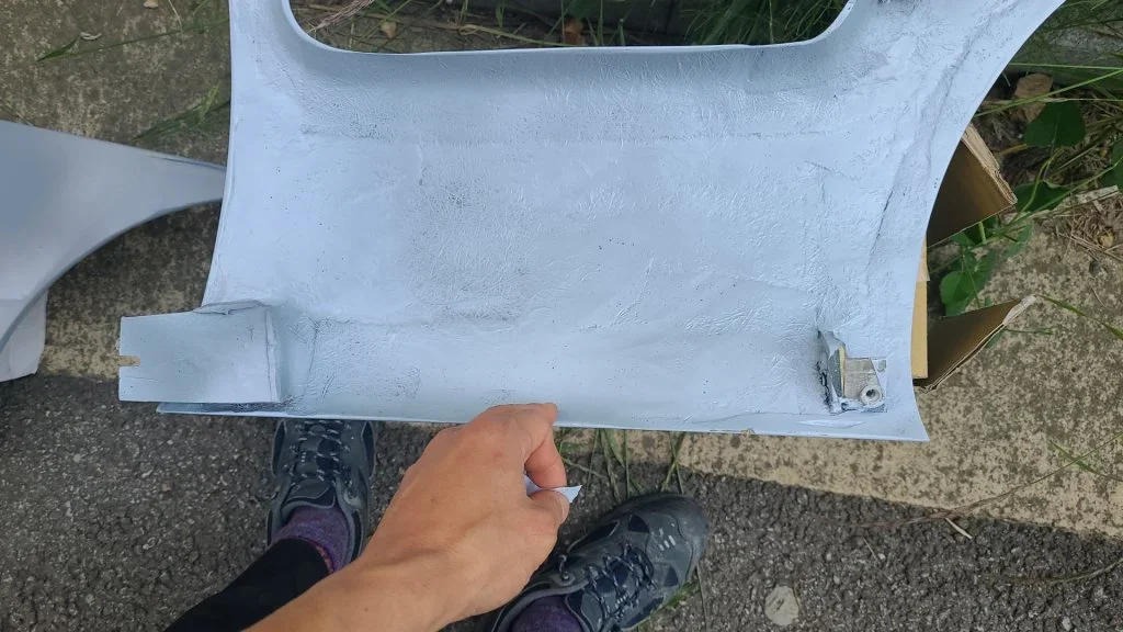

Cut away the gelcoat to expose the fibres and rough up the edges to give the new grp something to bond to.
Clag it in there
I had to move the swage line but I did that a couple weeks ago. Previous page.
The gap is now around 5 or 6mm so still pretty big but at least the front shell is straight now. The leading edge of the door isn't straight so that'll need a mm too. But also the way the z3 hinges work with the wider doors means the door swings forwards when opening and makes contact with the rear edge of the front wing so a biggish gap is necessary. Maybe 5 or 6mm is as close as I can get it.
ruan
Apr 26, 2024
28
Berkshire
Are you going to add location pins to the bonnet to pull in the bottom edge? Thanks for the tip about the door moving forward as it opens, this is the type of detail that makes these updates so useful.
If the front body shell was just a single sheet of grp it would be quite wobbly and locating pins would work. But it is very strong. Multiple sheets of grp. It really is rigid and pins wouldn't pull it in.
I showed how I fixed it a few posts ago.
Another idea I'm toying with is to cut it across here just below the swage line
and bolt the bottom part to the metalwork just like the Z3.
The wiring for the turn signal is there by the A pillar. Also, lifting the front will be nicer on the wheelarch liner without that panel swinging forward. Also be able to have that panel perfectly aligned with the door panel and sill.
Won't be an easy cut because the panel is double skinned and the bonnet hinges are roughly inline with where I want to cut.
Need to think about this one but I do like the idea. Watch this space.
