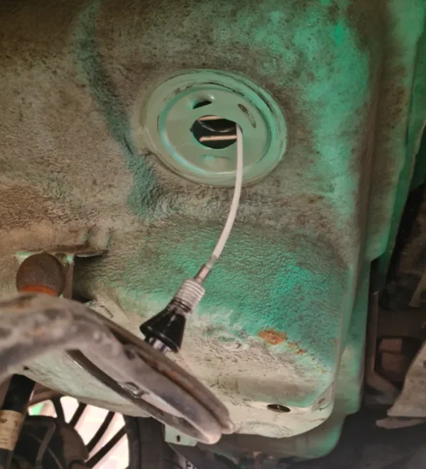

right.....I got the spare wheel carrier off ...but ..stupid Question No.53.... how do you get the bloody thing off the car !?...it's swinging in the breeze at the moment... not sure how you disconnect the cable

Jack Ratt

thought I'd pop off the spare wheel carrier... thanks for the tip @Jack Ratt ...took all of 5 minutes !.... then realised I must have the M sport wheel carrier, as that big hole is surely for weight saving ? :D

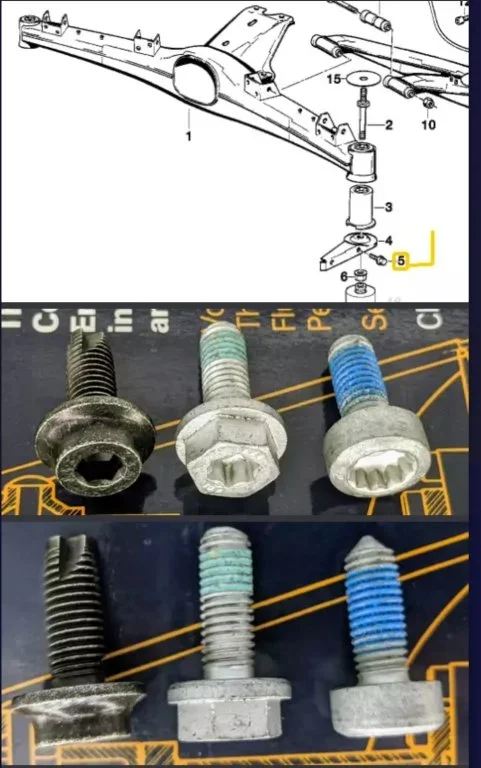

morning...so my attention turned to subframe plate bolt replacements and there's a lot of discussion on tensile strength etc.. came across this on one bimmer forum. chap replaced his with Audi brake caliper M8x22 bolts .. he lists part numbers left to right. I'm wondering why tensile strength is so important given the subframe load is taken mainly by the two main bolts?

Do you know what others on the forum have used?
Annoying (and somewhat baffling) that BMW no longer sells those bolts

The beam mounting pins take the acceleration and braking forces. Without the pin being secured at the bottom i.e underneath the cross beam, then the mounting pin can flex / bend. Locating the bottom of the pin using what are called by BMW 'Thrust Plates' keeps the pin dead vertical.
If you were to brake heavily the beam and trailing arms will try and slow up naturally, the body however will try and carry on as normal. Those 2 mounting pins hold the body back, located at the top where they screw into the body and at the bottom where the 'thrust plates' are bolted to the body side. The 'thrust plates' taking some of the thrust on acceleration and retardation forces on braking. The forces act laterally putting the bolts under shear plane stress, too weak and they can shear.
aaah interesting!... so they do receive shear force...odd that something only M8 is subject to a shear force of that magnitude..

There's no reason not to get these bolts from a fastener company. Grade 10 bolts are quite common in engineering. Granted, they're not as common as grade 8 but non the less you shouldn't have any problems getting them.

cheers mate...I never gave it a thought before, was just going to get M8x22!.. I inherited my Dad's tools and part of that is a box full of "come in handy" bolts....I wonder!
