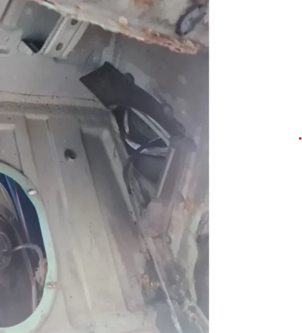

I just did my Miss Marple bit.. and found a photo of said drain hanging out the 'ole
I found a picture of mine when I repaired it
That drain tube is quite long
That drain tube is quite long View attachment 359819
showing off your long drain =)) ... yeah I disconnected my tube from the gaiter as I didn't want to snap it off... so yesterday with just the tube tried poking through various gaps and none looked right. But it is just literally poking it where there's a gap between the tank and the body and as you say, pressing it into the clips. Now I've found the "before" photo I get it now...

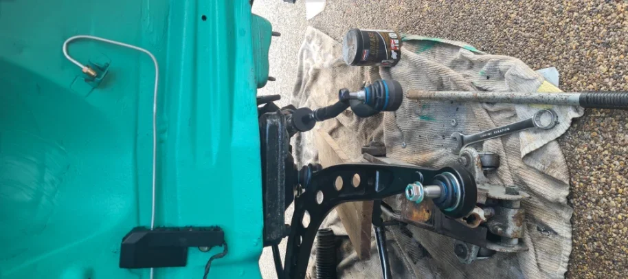

UPDATE.... I'm in !!..... laid the lollipop on the ground, soaked it with silicone grease, pushed the wishbone in and leant on it with my bodyweight with like a sawing twisting action. Got the end level with the back hole of the bush, turned it upside down and pushed it home !!
ok bit of a frustrating first day, but.... got something done !!.... let me run than lollipop past you again...laid it on the yes a very dirty garage carpet
squirted it with silicone spray, then sprayed the end of the wishbone, and basically went for it... if you hear squeaking that means it's moving
so with brute force and ignorance I went at it
got it so the head of the post was touching the floor, turn it round and pushed down on the lollipop and it eventually "gave up" and slid down.
so that enabled me to get one lollipop on the car after about an hour wrestling with it...and there it is... SO glad I zinced those bolts
The reason I didn't want anything else in the way was so I could access that middle nut with a spanner.... so I jack up the middle ball joint to stop it spinning. To get the old nut and wishbone off I used a 22mm open ended spanner. For the Meyle one that was too big !. end up using an imperial one to sit snugly. Not sure how i'm going to torque it yet as you can't get a socket on it. Might have to go from the top with extension bars
Test fitted the new inner and outer tie rod
So tomorrow all hangs on me getting that other lollipop on... if I do, I should be able to finish the front end.

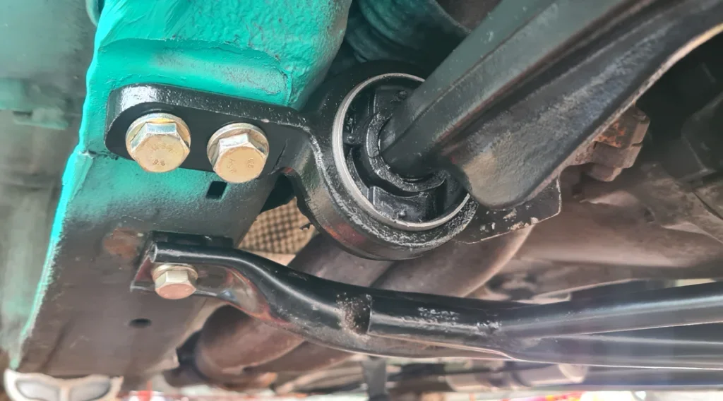

Then on with the Anti Roll bar, completely refreshed with new bushes and brackets
