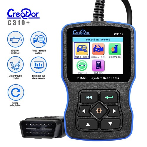

Looking for a decent scan tool read dsc and air bag faults. Looking for something other than peake
Mine in a pre-facelift 1999. It does not have the OBD port under the dash. Creator 310 works OK on the round connector in the engne bay.Creator works on my 1999 1.9 wide body ok with the 20 pin to 16 pin cable changer. Mine also has the 16 pin OBD2 port under the steering wheel but that port only reads engine and transmission modules. The 20 pin round pacman socket in the engine bay reads all modules. My car is a December 1999 model. Change over to OBD2 was earlier in 1999 so you may have obd1 on yours.
