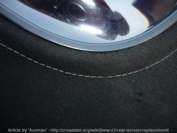

Hello folks. I have been a "car guy" for years, but never owned a BMW. My wife and I bought a 97 Z3 with 65K miles on in it this past weekend to use as a summer play car. I did notice the current rear window in the car is pretty foggy and needs to be replaced. I did not look at it closely and I have not yet picked the car up from the current owner (work thing getting in the way), but one thing I am confused about is I did not notice a zipper on the window. I did look at the outside of the window/top and noticed some sewing stiches and because of that I am assuming the zipper is inside? Did all of the Z3s come with a zipper? Thanks in advance from the wet Pacific Northwest.

I fitted one of these windows a while back with no problems. The only slightly disappointing point was that it was impossible to tuck the canvas back into the window surround, it had to be glued which doesn't look so good.
I now have 2 z3's needing replacement windows and there is an advert on eBay, send your old window in and he will sow a new window into the existing zip for £59. I thought this may be a better option as it uses the original window surround and there would be more chance of tucking the canvas back into it.
Bear in mind that I have done this before but I just cannit get either window to zip back in, I'm using the same zip pull as I used last time.
I found the zip pull very hard to zip around the replacement window on it's own so have trimmed back the replacement window to make it easier.
I've been at it for 2 days now and just can't get them in. As the zip goes around it just comes undone. This is the same on both roofs. On the second roof, the zip is now coming away from the roof as the stitching is weak.
Anyone else fitted a window this way and have any bright ideas?

Anyway a bit of progress. The zip was very hard to pull around the window and I worked out that it was catching on the new clear window where it had not been trimmed back enough. I have been all the way around the window trimming the new clear section back as close to the stitching as I can. The zip now runs easily around it.
However now when I try and zip the window in the zip won't stay closed. After trying for a couple of hours I threw it all in the corner and went off to the pub to sulk. After a few beers, it dawned on me that it was now the zip puller at fault. In trying to pull it around the window with the clear section catching it had caused the zip pull to open up which stopped the two side of the zip closing. Pinching it up in the vice and it went in first time...........result at last. The good news is that the roof tucks easily back into the trim and you wouldn't know that the window had been replaced. Much neater than buying a new aftermarket replacement.
If anyone needs any help......you can sod off, I'm never doing another one!

Yes, the 'rubber' seal comes with the replacement window.

I've just fitted the one that is attached above and no there is no seal, but there is extra cloth that needs gluing in place
