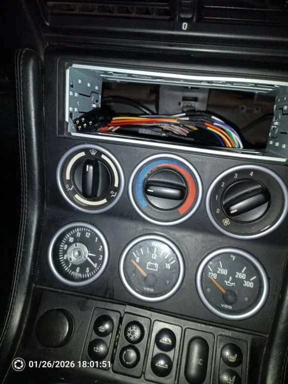

I'm keeping myself busy with quality of life improvements for the time being. The first being a phone mount. I should mention I don't like the way phone mounts look, so I want to make it as covert as I can. That's when I noticed I have a clock that is really bad at keeping time, and I never look at it anyway.
We can also see the trim is in very poor shape. I'll have to see if I can 3d print replacements. The original glue residue still shows...but lets not fixate on that. Look at this clock. The vinyl wrap is not great either. Which makes sense. This is the first one I ever did, so lets take it out.
I picked up a phone mount with a threaded insert....which you can't see because I didn't take a picture of it.
At this point I completely gutted the clock and added some new hardware. I then cut the clock hands off and glued them to the clock face.
What I have left is this...
Also a nice new vinyl wrap was applied. The idea here is that when I want I can hook up the phone mount to it or completely remove it and we'll only see the threaded hole. Which I'm hoping won't be too obvious.
Hhere is the phone mount now mounted to the modified clock. It has an adjustable arm for easy positioning.
Ignoring the missing stereo (I'll address this next post.)...and how damaged the trim is...tbd...we can see the gauge mounted back in and I'm pleased with the look. Also notice the time is 3:20 (3.2L get it?!). It still lights up like a normal guage as well:)

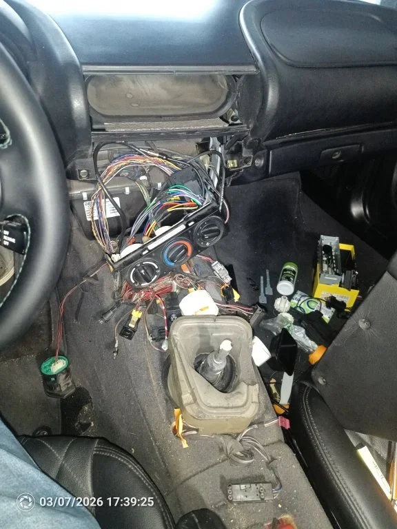

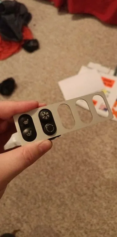

I then decided to completely remove the center console and address the cracked plastic shifter surround.
The plastic trim around the shifter is known to be a weak spot. It is extremely common to see the plastic around the AC buttons to be cracked or missing. Here is what mine looked like.

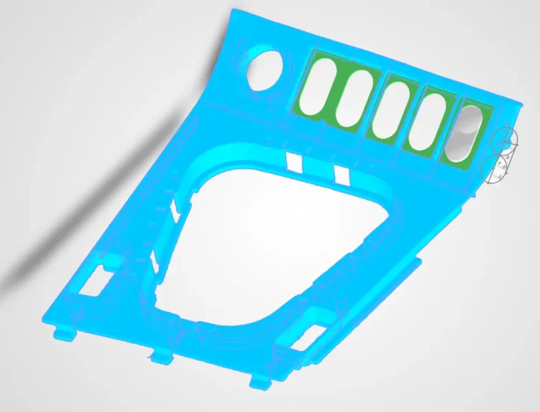

They are also crazy expensive to replace! Even 3d printed ones. I decided to try and salvage what I have and see how that turns out. So I scanned the trim and buttons in with the idea to replace them with an aluminum surround. This was a great learning process for the scanner and getting familiar with SolidWorks.
The initial scan of the trim.
Then created a something that I thought would work.
Next step was to send the design off to SendCutSend and got some nice clear anodized aluminum pieces!
They fit great! This might actually work. I then assembled everything, but not before vinyl wrapping the stained & scratched plastic. I did this to both the shifter surround and the stereo & gage pod trim.

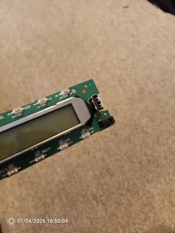

As I mentioned in earlier posts, I turned my clock into a phone mount. I also replaced the cigarette lighter with a USB charger. Since my stereo has a front facing USB port I decided to take apart the stereo and solder a USB cable to it and extend it out the back. Why do this? Cables are ugly. This reduces cables in the cabin by connecting the phone to the stereo through the charger in the cigarette lighter position.
This is the stereo face and USB cable. The next step was just to add a USB connector to the other side.
Then I punched a hole, added a nice grommet and ran a cable out of the back. I should mention I also hot-glued the cable to the connector inside the head unit.
What we have left is a pretty clean setup. I have a dedicated 4 inch (~10cm) USB cable to jump from the cigarette lighter position to the phone mount just above it. Nice and clean. You can see here that the aluminum looks pretty good. Ignore the missing volume knob and vent....I got ahead of myself and took a picture before I was finished assembling.
