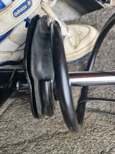

Also worth bearing in mind Z4 springs don’t sit on the rubber pearch how you would think, they sit about 2/3” back from the stop at this point you also see the natural shape of the spring sit snug round the base, they’re only pear shaped very slightly one end.

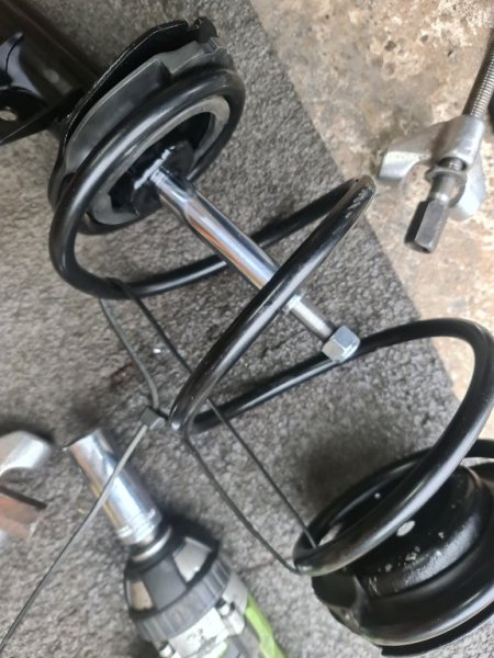

This is amazing, I have been working on cars for 57 years and the spring and shocks are doing my head in, a simple job. Never come across springs that don't seat in the standard place. Now I have another problem on compressing the springs to fit, they only have 2 coils to attach compressors which is not enough to fit top mounts. Any suggestions. Pictures attached where I can get spring to seat on bottom perch and another showing how far springs have to be compressed to fit.

Just watch Bavarian Auto video, now order the compressor they use with top perch.
