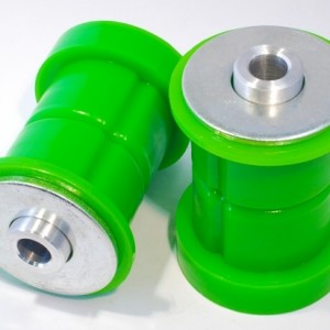

Right, further to the 12 tonne press. I've machined a puck to help push out the old bushes square. I used a Powerflex bushe for size and took 0.5 off the OD to make it a better fit.
We have @ZTec dropping his zed in this weekend so he will be the first to test it on. If all being good we can do a 1 day turn around on subframes :p

Nice bit of maching, do you have a cup for the bottom of the beam to allow the old one to pass through or are you just resting on the press?

I have a pair of parallel bars to sit it on. I see what you mean though, I keep thinking it over, It will be supported on one side and only the lip on the other. Will see how much force is actually needed.
