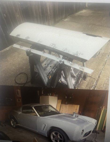

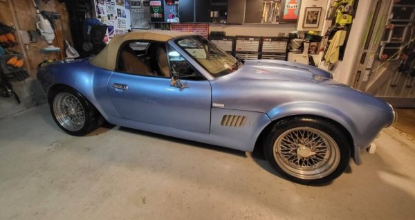

My paintshop, who only do GRP, told me there is no need to bake and didn't.I will start with the bodywork soon,would you recommend me to bake the kit in paintshop oven before or after the bodywork is done?

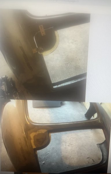

The kit is also very thin in few places so I will laminate and strengthen it to achieve sufficient thickness.
Colour choice is not something that anyone can give advice on....the beauty of building a car is that you can paint it whatever colour you like.
Although I personally think if it's anywhere near looking like a Ferrari it should be a shade of red!
I think all these GRP panels are thin and thick in different places. Mine is 2mm in some spots and 8mm in others and a variety in between. Spending a lot of time and effort strengthening the thin spots won't really give you any advantage IMO, but if you want to.......
