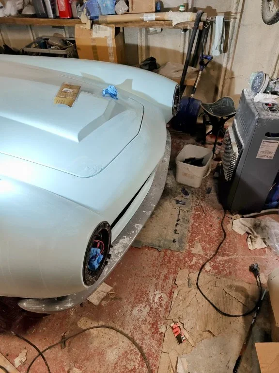

Second round of filling done today, now blend it in and see if I can get it anything like the other side.
Seems like a lot of work. I'm sure we're all from the same mold. I did all my work around the bottom half. Cut it and pushed it back about 2 cm and bonded it back together. Made a real mess below the light but I had to make a mess down there anyway for the indicator.

I saw that different people had done it differently so I asked Chris for his suggestion and he suggested wrapping the bowl in tape, getting it in the right place and then filling in the top behind it, so I've tried that, so far it's not going too badly I think (famous last words)
I really like your indicator mod with the back plate. I've got the chrome karmann ghia ones so not sure it would work on mine as it would push the indicator in front of the headlight, hence I went got the recessed mod. Still not 100% but it's just minor fettling to get it right now.

2nd fill and sand nearly done. Now need to get a finer filler to get the last bits and then gel coat:

Did the first layer of gelcoat, sanded it off (well it was off in places and uneven in others - not my forte), and have applied another layer:
will give it a while to set, then sand it off again :oops:

Ok, so sanded it off again, looking a lot smoother but still managed to go through in a couple of places, but it's getting near to the point where I say stuff it, it's good enough till I do the respray 😅

Ok, new plan. My gel coating has gone dreadfully so I'm giving up for now. I'll polish up the bonnet as best I can and come back to fixing the gel coat later. It's half term so hoping to get the indicators positioned and the holes in them filled. Any advice on fitting the grills?
From the pic, I can't see what the problem is with your gelcoat.
I had major issues with my indicators. I got the chrome Karmann Ghia ones with clear lenses. When offered up to the bodywork they pointed downwards. I think my mould differs from everyone else's. When Chris was doing Dan's mould, Dan provided the paintable Karmann ghia ones so I believe Chris did the mould to suit those...hence better fitting on later moulds.
I had to recess mine (sort of retro-mod look) to get them to angle correctly.
I tiger sealed 4 small 45° angled brackets on my grill surrounds (the type kitchen fitters use for angled base plinths). The mesh is held in place with small plates that fix through the angle brackets into the bodywork. I'm going to try and wrap the chrome work 😎
My kit was supplied in november 2023. My indicators wanted to point down too. I took tin snips and chopped them to fit.
