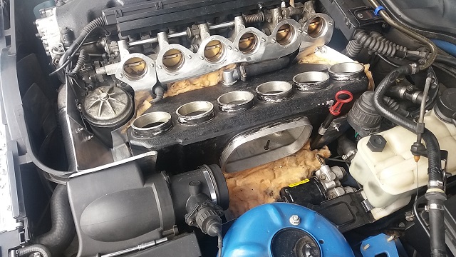

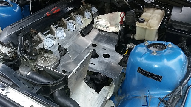

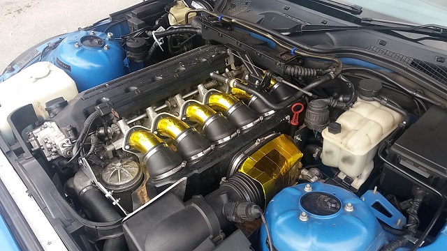

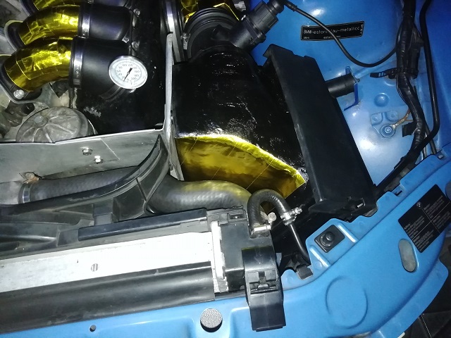

Aluminium (for intake cooling & shielding) - £21.58
Loft insulation (for intake cooling) - £0
(I've tested it - and I can't set it on fire!!!)
Stainless steel mesh to keep loft insulation in place around MAF-to-Plenum elbow - £4.99
Gold heat tape (for intake cooling) - £19.58
(I can't set the gold tape on fire, either!!)

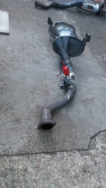

Exhaust modifications...

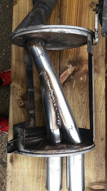

Made straight through muffler using 304 Stainless Steel

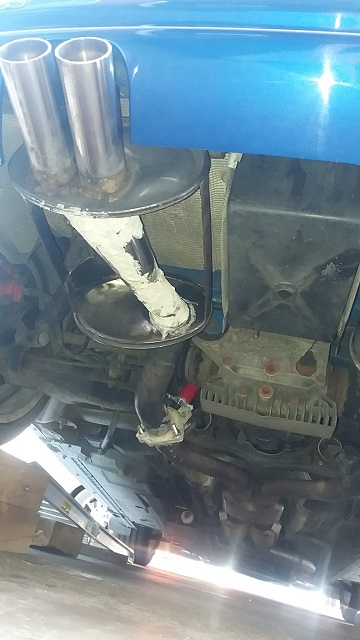

Rear exhaust section with a bypass valve fitted...
and fitted to the car...
Total cost for the stainless steel tubing, argon gas and stainless welding wire was around £100.
Bypass valve and switch was around £35.

That's an impressive list of jobs Pingu. Whats the exhaust valve do? Open up that branch of the exhaust? How is the noise?

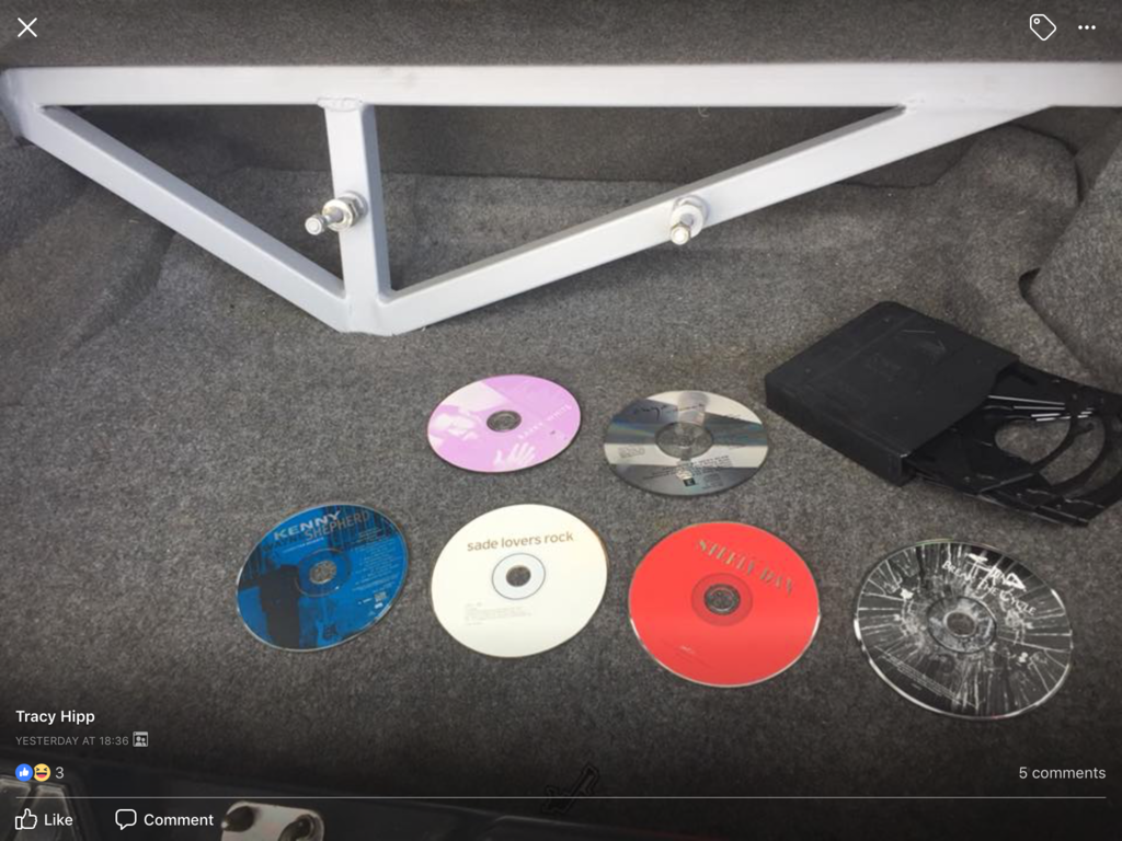

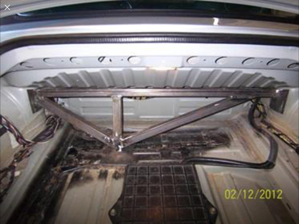

I spotted this on Facebook the other day, another solution I have not seen before
He uses it to scare old ladies......

Holy s***, theres some over kill, saying that if you are tracking your car regularly it may well do the trick
Yep, this is on an ///M that is a track car.
Yes, it works as a town-friendly car with the valve closed and as a monster with the valve open. It's perfectly safe because there is a cross-over pipe.
The comment from some bikes that I passed was "By 'eck, that's jolly loud. old boy", or something like that - I couldn't hear them properly:whistle:
I'd consider this as a strut brace, but without the trestle. The downside is the added weight. I'd probably use an aluminium strut. I think that it could be hidden quite easily. The solution that I had in mind is not as good as it would infringe the hood space.
I'd need to measure the twist in the car to see whether ANYTHING is required and WHERE to spend my effort before I do anything, though.
I'm starting to think that brake mods are what I will need soon:wideyed:.

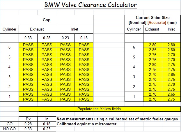

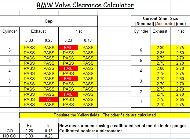

Valves Checked...
Original valve shims...
New valve shims...

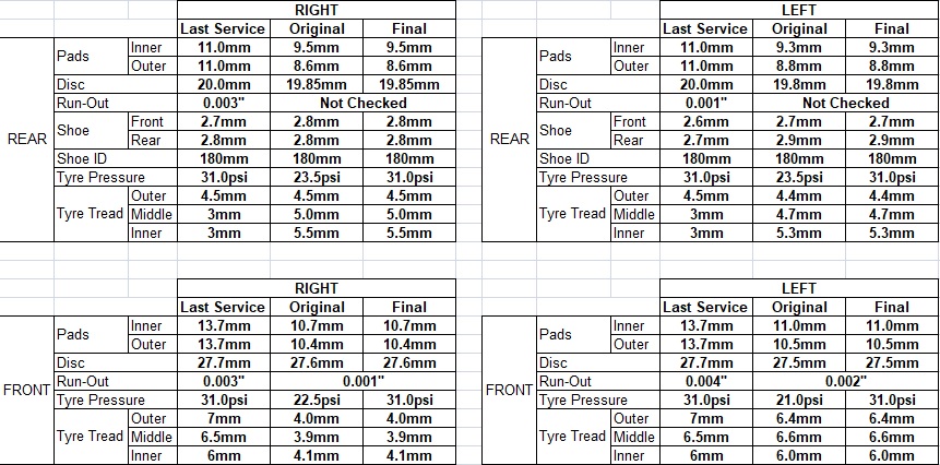

Tyres and brakes checked and measured...
