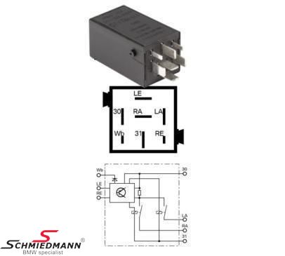

I made it half way round until the indicators and brake lights gave up the ghost...
Pingu
3rd Party Trader
Dec 8, 2011
145
The indicator was found to be one side of the hazard relay was shorting out.
I had to replace the hazard relay, which wasn't cheap, but Schmiedmann were the best source of an OEM one...
BMW Part Number = 61 36 1 388 533
[edit] Plus 29p customs tax - and £6.65 FedEx admin fee :eek:
