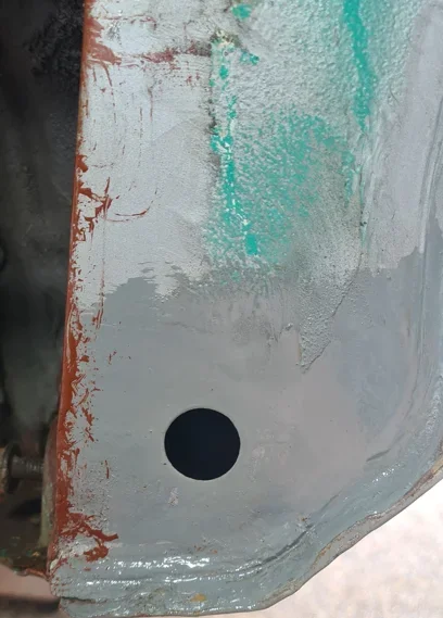

Firstly, a quick check to see how the POR15 is fairing up after I put it on in June..... Front offside Sill, which I welded back up...... I have brown spots leaking through !!..... now this is probably due to my workmanship as the other three sill ends are fine....
what I think I'm going to have to do is grind this area down and use my MIPA Epoxy primer instead and see how that fairs.
