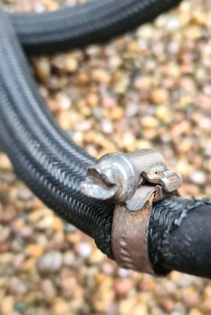

first job was to remove the old fuel pipes.... not helped by the slotted heads being ruined and the nut heads rounded off by a previous "careful" mechanic so it took half an hour to get them out...not going to fit the refreshed fuel pipes until I get the "double ear" fuel clamps, arriving at the weekend
