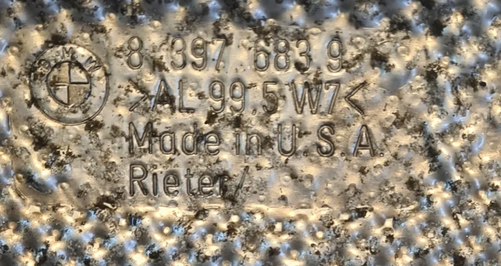

I also cleaned up the VERY grubby heat shields...…. just sprayed on alloy wheel cleaner and let it do it's thing (turning purple), then got in there with a stiff brush using jabbing and rotary actions.... then hosed off with the Garden hose....
This is the number in case anyone needs it...
Same with the other two...….quite surprised to see rust., and some of the fixing holes had actually rusted through. I'm no metallurgist, but that's clearly not aluminium !
