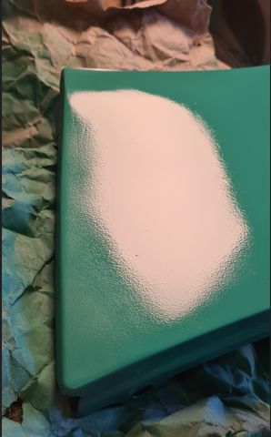

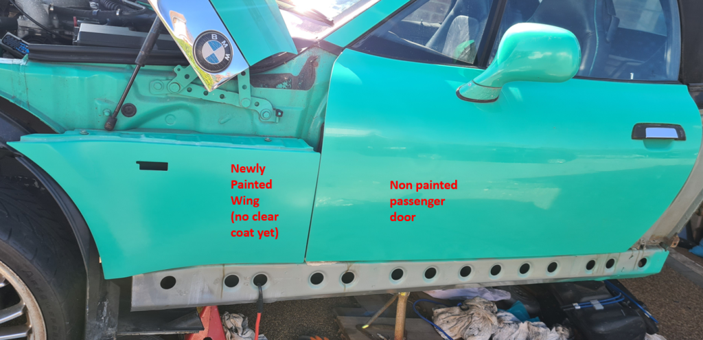

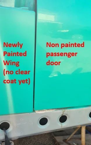

Laid down top coat over my repaired repair.... and I've finally gotten rid of the lump that was bugging me....
as before, it looks orange peely but dries dead smooth

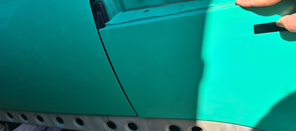

Uncovered the poor car to let it have some sun and Vitamin D =)) =)) ..... offered up the freshly painted wings and the colour match is superb !!..
the next stage is to tidy up the passenger rear quarter, paint that fully..... then 2k Clear Coat on the lot...

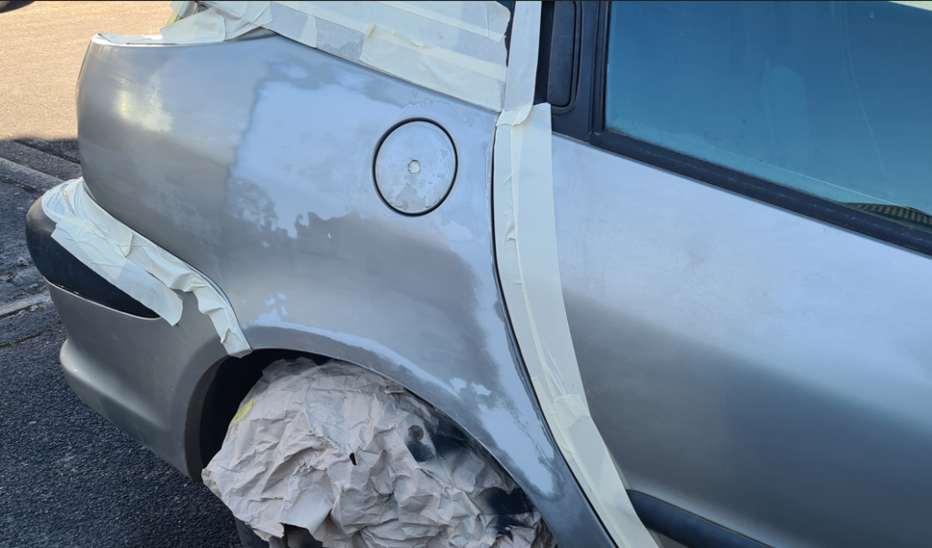

well there's be a couple of weeks delay on the Z3, and forgive me for posting pics of a non Zed, but while I had got my painting technique as good as I could get, I paused a bit so that I could paint the rear end of my Peugeot Estate...
it's sort of relevant in terms of prep and getting the preparation right is absolutely key.... getting the right grade of sandpaper, then flatten with wet and dry around 2000 grit. I then went over the whole area in Meths (as I didn't have panel cleanser). Then a nice even spraying technique from a rattle can. Leave 15 minutes between coats. I did three decent coats for the rear quarter and then blended in the door, finishing about halfway along the door. Let that dry overnight (luckily it was decent weather!).. then another light wipe over, then three even coats of rattle can clear coat... let that cure for a week before any cutting or polishing.

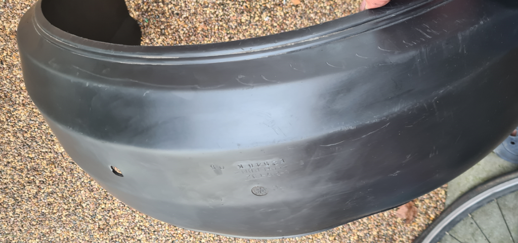

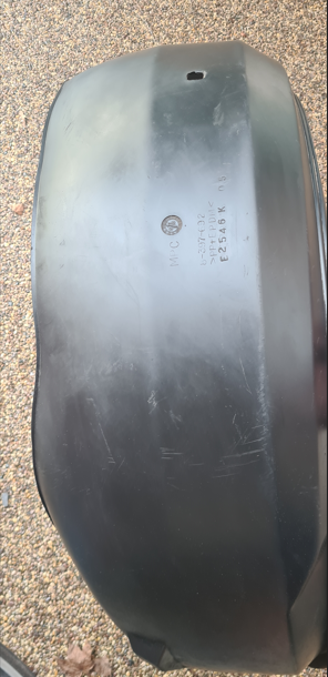

Thought I'd tart up the wheel arch liners with the WD40 trick.... came up quite well !!

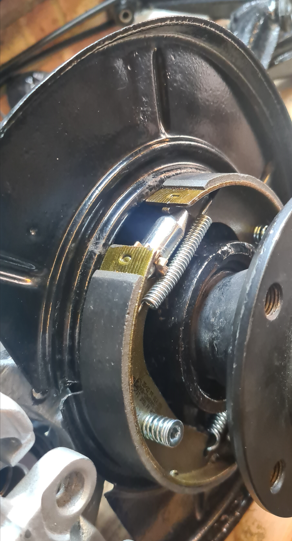

today I thought I've have an easy session putting the new rear handbrake and new shoes and fittings.....:whistle: :whistle: :whistle:
handbrake mechanism went on fine and one shoe.... fine.... bottom spring.... oookkkaaaay.... top spring !... aaaaarggh !!!... half an hour wrestling with it...
I tried levering with a screwdriver.... nope.... pulling with a bit of garden twine.... nearly !!
I could get it over the hole... but not enough leverage to clip in....so for now I've given up as my hands are hurting.....and I'm in danger of not being able to hold my glass of Gin....

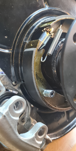

STOP PRESS !.
.... right... I wasn't going to let it beat me.... so tried a different screwdriver levering technique and..... SUCCESS
Took an "after the fact" photo, to remind me in the future !!.... use the hub for leverage and just enough of the screwdriver tip to hold the hook

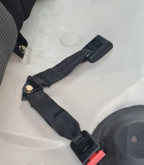

ok so it's been a while !....had to do some work on the Peugeot, fitted a new DPF, repaired a hole in the boot floor and as the seat belt brackets and bolts were rusted...you know what I did didn't you..... yep, clean, prepped and hammerited the brackets, and... zinc plated the bolts ! =))

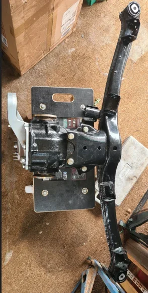

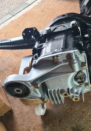

right.... first ....gather all the big bits !
and start bolting them together !.......... and no I haven't added the Diff gasket yet... ( this is me lying on social media... ssssshh)
so far so good....... then..... I'm about to hit my first snag..... those who have done this on a trolley might guess what it is.....no scrolling for the answer and don't copy your friends answer !
ok so here is comes........ adding a Trailing Arm.... you quickly realise.... idiot... the hint centres around the washing up bowl
That's right kids !.... now I can't move it !.... yay !!! or move it under the car ! yaaaay !!!
decided on Trolley 2.0 which employed some handy planks (actually it's pallets that I broke up)
now for round 12........ on with the subframe and Trailing arms.... and ???..... yep the whole thing collapsed including the wheels..... OH how I laughed.
It actually trapped my foot, so after much swearing and pulling... I thought... "it's either my foot or the croc.... one of us has to go".....so I sacrificed my trusty croc....
I sensed another modification..... bracing !.... Trolley 3.0
now we're cooking with gas !!... so flipped it over and away we go...
so for now.... we have a rear subframe !!.....
Next steps, apart from putting on the driveshafts is to tighten and torque everything. I might wait to put the rear discs on after I've put the subframe back on the car....
