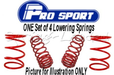

A shiny set of
Long story short, I had a touch of that covid stuff a few months back that left me a tired old man. Didn't have far to go, anyway. Finally got round to fiddling with the Z last week and thought it seemed a bit lower than normal, OSR spring has collapsed. Hence the need for some new ones.
And they are shiny, which is always good.:thumbsup:
Now I just need to summon up some energy to fit them.
